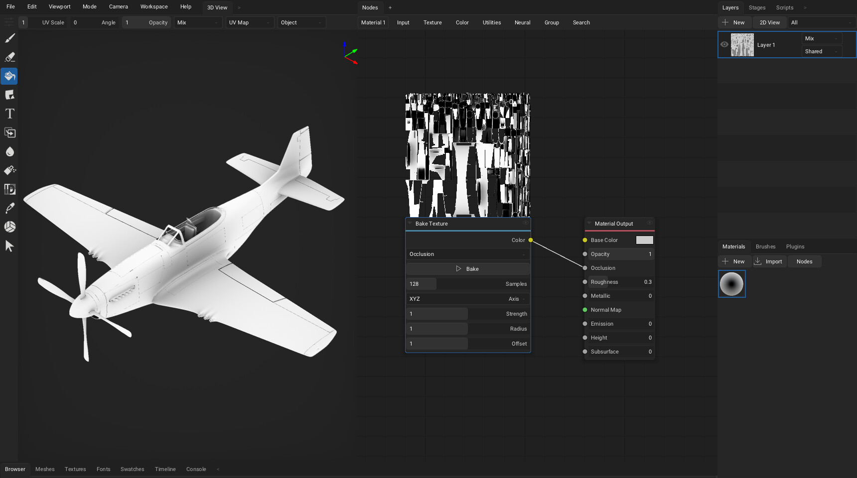

Thanks for pointing it out. Over the years there was a constant confusion in regards to the bake tool and how it works so I have decided to rework it and make it more versatile.
Up to now it basically always stored the bake result into the base color of selected layer - so when ambient occlusion was baked, it ended up in the base color channel instead of the occlusion channel, etc.
Now you can access the baking features via the new Bake Texture material node. Once you press the Bake button, the baking result will be stored inside the node. You can further process the result as needed by connecting it to other material nodes, or connect it directly to the desired channel of the Material Output node and use it in the painting process.
You can also right-click onto the Bake Texture node and click the Capture Output button. Now the bake result will be stored in your Textures tab and you can export it directly to the disk from there if you wish.
I am hoping to update the manual, record a new video tutorial and update the release notes asap to make it clearer. Will continue to improve the baking, please feel welcome to report any issues.
