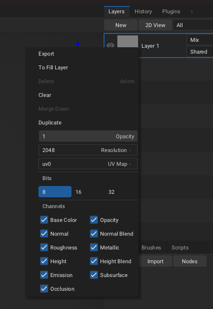

Hello, there is an initial support for the second UV map:
  • Second uv map can be imported via .fbx format
  • UV map can be selected per layer
  • Second uv map can be accessed via the UV Map material node
Will try to further improve it.

EDIT: Oh, and also… It would help to have two UV maps to select for a layer. Right now I need to alter each material to source from “uv1” while the layer has to paint to “uv0”. It would make things a lot easier if you can select the target UV map and the source UV map (source meaning, which UVs the material/brush receives in contrast to which UVs the layer paints)
